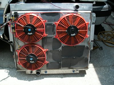

The old radiator finally rotted out, so I replaced it with a Champion aluminum and fabbed up an almost air tight shroud for the e-fans, with one way EPDM flaps riveted on for "open cruise/closed stop" action.

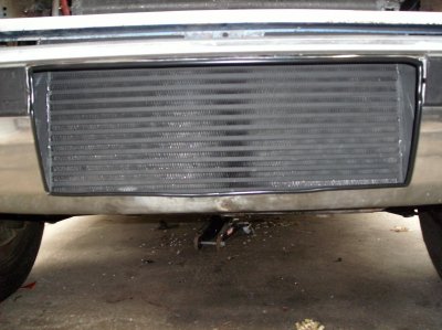

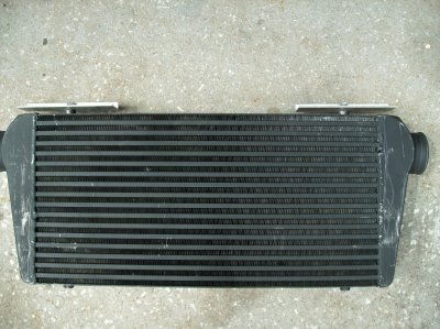

Since charge cooling is is important (especially in summertime FL.) I got a 31"x12"x4" bar and plate 'cooler- 3" in & out.. Bottom brackets in place.

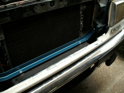

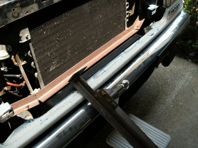

Don't know about you, but anytime I see an old bed frame in the trash, I grab it- and I don't sell it for scrap since they are great for making things out of..
Some minor dental surgery was needed to get fresh air to the 'cooler, so the task was attended to.
That piece of bed frame angle in its finished form as the 'cooler upper support bracket.

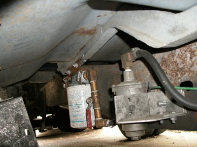

This is a little earlier in the scheme of things, but the Walbro Industrial E-Lift Pump with the isolation valves & Goldenrod water block pre-filter in front of it has been a real life saver, I just keep a spare filter behind the back seat. It can be completely swapped out on the side of the road in under two minutes.

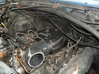

The Airaid 300-100 intake hat turned out to fit perfectly, but I'd like to use a gasket for a good seal- does anyone know of something, flat or O-ring, that will work?

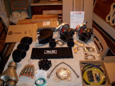

I have gathered all gaskets, valley pan, seals, rebuilt BB injectors, ARP studs, turbos, and most of the oil plumbing.. Yet to be acquired is the air piping and exhaust piping.

Oh ya, I'm looking forward to this build. I'll be following right in your foot steps, besides the twin turbos. But I'll be doing the intercooler and that air raid intake hat looks like a good piece to have for routing the pipe. Can't wait to see how this turns out

Vandy, You know that I'm remote mounting those turbos, right? That Airaid hat is made from some kind of thick tough plastic, but I'm not sure it would be the best solution if you're gonna have your turbo in the traditional location..

You don't think the turbo in its normal location will clear that intake hate? I know you can use the factory ats hat and run an intercooler, it just looks like a pain. I planned on using r&d's intake manifold when I did my intercooler but that air raid intake hat looks like it would work and make running IC pipe a little easier

Oh I didn't even think about that. I doubt that would be a problem, especially since I have a turbo blanket on the exhaust side. I can drive it to work and pop the hood and lay my hand on the blanket and it's barely even warm.
