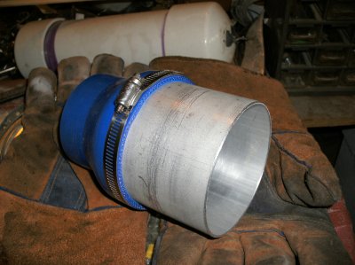

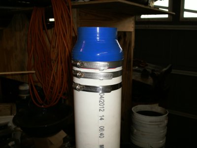

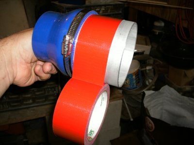

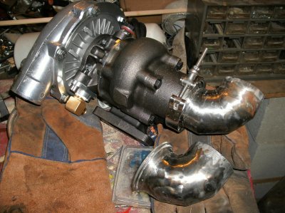

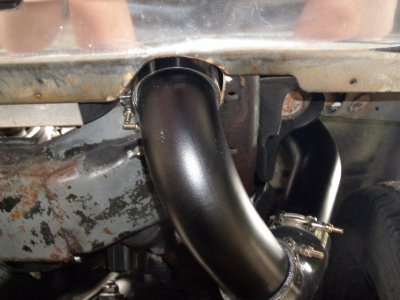

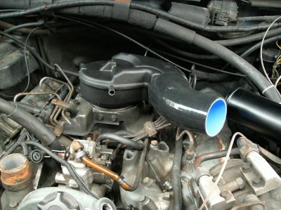

Been getting a lot of rain here, practically every day, so most of what's been done over the last week has been in the shop..
I fabbed up two small radius turbo exhaust pipes and got the V-band flanges welded on..
Did a little surgery and got post intercooler charge piping in place. Looks like I'm going to have to use a spacer under the intake hat to get piping to clear the injection lines.
Took some thin wall 4" O.D. aluminum tube and cut two 4" sections for the transition from the 3" proper silicone & alum. tube intake section to the 4" Sch.20 PVC Redneck intake section.
Also picked up a 1/8" NPT tap and drilled & tapped the compressor outlets and installed tubing elbows for the boost control tubing. The 1/2" (8AN) Teflon/SS braid hose for hot oil return should be here tomorrow.
Questions-
Should I run 1 pyrometer or two? Is there "typical" for parallel turbo setups?
Oil supply banjo bolts supplied with turbo were too long and bottomed against flow restrictor in hole,
so I took restrictors out, thinking that mid section of turbo probably had nothing to impede the flow
through to the drain side, so no overpressure (i.e. smoky turbo) should occur, right?

Egt is really just to save your engine, not turbo.
So just one.
But if you run it hard or whatever, just give it a few minutes for cool down before shutting it off.
