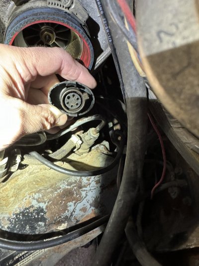

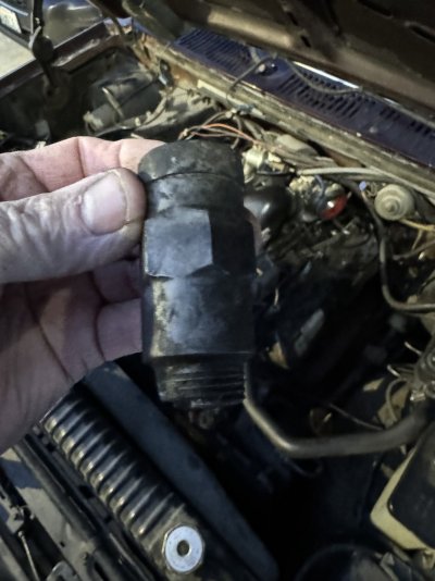

I had a coolant leak at he back of 7.3L IDI and I found a sensor on the top of the intake manifold was leaking.
It's located at the drivers side rear of the manifold. The sensor actually popped off as soon as I touched it.
I obviously don't need it, but would like to know what it was for. For now I plugged it off. I found the connector that I think was plugged into it.
Any ideas?

I'm going to assume that's 6.9 specific, and may be for the glow plug system, because I've never seen that on any of the 7.3's I've worked on.
The original owner had it converted from a 6.9 to a 7.3. Maybe they installed the 6.9 manifold onto the 7.3?

That's the glow plug control for the 6.9.

Definitely the 6.9 glow plug controller, it's what would have been stock on your 84. Having a later 7.3 installed, they likely swapped it to the 7.3 because they didn't know it wasn't needed.

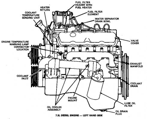

Thank you a bunch...that is better than a pin-up...much more to look at and admire...
Can we ask you to post the other side of the engine...? Just to make it even...?
I have this thing about uniformity...and the other side needs to be exhibited in all of it's glory...at least I think so....at least for those of us that are looking for the block heater...'n such...
Thanks in advance...

The top of the engine is impressive to when it's a line drawing like that.
