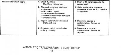

so take a peek here.there's only so many reasons for not getting converter lockup (a full signal which should stall the engine right out at idle in d.)
so start at the first one.how is the fluid level? did you check it with engine running in P or N when she was up to operating temp?
for the second one,did you cut the wire and run a line from the tcm side and a line from the trans side into the cab?
what color was the wire you cut?
3.im not sure right off which seal it means here.
hopefully someone shows us using the pics in log truck thread? maybe that's one of those split seal/kind o-ring looking seals around the shaft there.probably just what it is.....guessing here though brother.
4.is the plastic ****** i just showed ya.
5. though could just be a converter who gave up the ghost lol.i should think if it doesn't have enough clutch material to lock (firm enough to stall the engine at idle) that you'd have a crap ton load of black clutch material around the magnet in your pan though brother.like table spoons full or something! lol.
edit,oh opps.speeder already listed these reasons in post #5 too.
