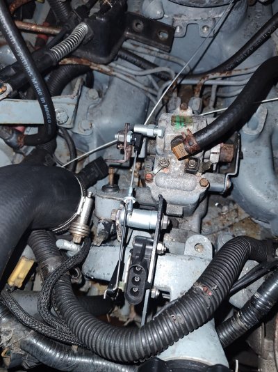

Yeah. I got the kit from CA Conversions and the cable supplied extends out to about 52 inches but the linkage pulls in the wrong direction, unless you don't mind having that cable routed over the fan shroud.
Now I wonder if I deleted that pic i sent to CAC. oops. Well, I found it. The kit I used can be found when looking for a "remote TPS mounting kit" and sells off for about $110.
Mine is about 98% done in this pic and I had to make a 32" TPS jumper wire to hook up to their kit.
