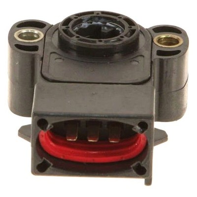

I've done a little research and tested my tps on my 93 f350 cc lb drw 4x4 7.3 n/a. From what I find I want 1.2 volts At idle position on the throttle, and 4.5 at wot.
Now my questions Are 1 is there any tolerance for it to be off or does it need to be dead accurate. And 2 is if my reads 1.5 idle and 4.06 wot... does that make my sensor bad because it's impossible to achieve the 3.3 volt difference between the specs seeing how my sensor has a 2.56 volt difference.
Please correct me if I'm wrong electronics aren't really my strong point

FIPL should be 1.1 volts in the closed position and no more than 4.5 volts at WOT. This is meaured by sticking a probe on the middle wire and the other to ground, then manually move the throttle from idle to full slowly looking not only for min/max but also bad spots in the range.
I have mine set @ 1.09 volts. When I set it at 1.2 volts it was revving very high to shift into the next gear. Play with the setting to see what you like the best.

There are posts all over this board about the FIPL, make sure you have the newer grey style. FIPL should be 1.1 volts in the closed position and no more than 4.5 volts at WOT. This is meaured by sticking a probe on the middle wire and the other to ground, then manually move the throttle from idle to full slowly looking not only for min/max but also bad spots in the range.

Why are you using ohms instead of volts???:dunno I have always used volts measured off the center wire on the tps switch leads. On a warmed up engine key on but engine off I prefer a voltage of 1.2 volts. Factory suggests .96 to 1.2 volts. We can't do anything about adjusting the high voltage. When we set the idle voltage and then go wide open throttle the wot is what ever we get. What we can't have it 5 volts at wide open throttle position. That will cause the trans computer to short out and we end up in limp home mode and thats really ******* the trans

I have mine set to 1.2 volts and that seems to work good. As Gary stated, we can't do anything about the high voltage. Mine is only 4.1 volts at WOT and it is Ford TPS.
The tps came to be when the first E4OD went into the trucks so that was probably 1989 which is the first year trucks had the E4OD. I'm not sure when the tps was used on the big Mercs and Ford V8 engine applications but if those cars had a E4OD trans they must of had a tps too. BTW these tps switches should be replaced around 50,000 to 75,000 miles. They are little more than a rheostat that has a metal strip rubbing on a wire grid similar to any heater rheostat switch. Think how many times our throttle moves and you start wondering how these switches last as long as they do. Snapon makes a nice scanner tool that measures the voltage and maps it out when the throttle is applied from idle to wot. It can show where the switch drops the signal to the trans cpu and we know what that causes. A simple volt meter can't show this either.

problem is that "idle" is relative to have fast you have your idle speed set. Just check with voltmeter each time you adjust, and find where you like it. 1.2 volts was always a good starting point for me.

The closest I could get the reading was 1.21 volts, lets just say it feels like I have a new transmission. Thanks for all the information you guys helped me a ton
