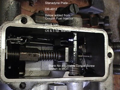

As far as I know that is the torque screw. This pix shows in the lower right corner the other screw, which is just a plug, hard to see, but it don't touch anything. I've got 4 IP's and will check to see if any are different from the one shown here.
These Pix are wrong also. For some reason a Quote won't transfer the Pix.
338
Sorry for the confusion, MY BAD.

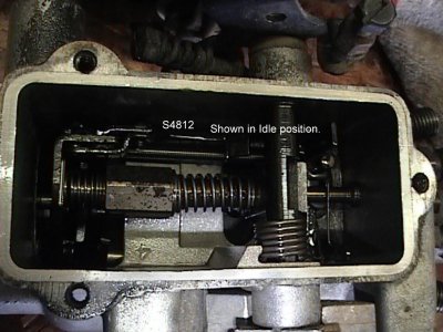

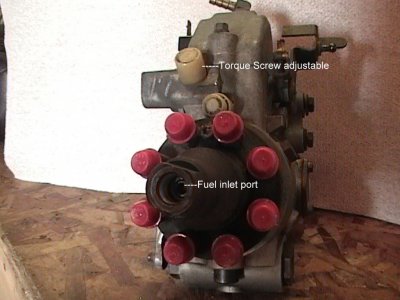

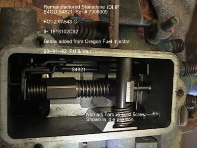

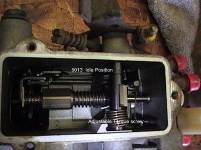

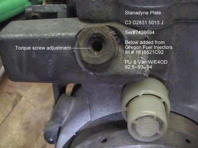

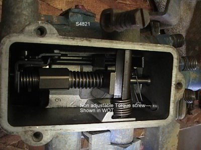

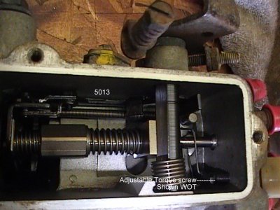

Here is the correct Pix of the location of the torque screw. Along with Pix of the three different IP's I have. I hope I have it right this time.
To mudduck
[/so you can turn the torque screw and gain more power also or what?? QUOTE]
I personnally don't know, never messed with one. As you can see from the Pix one is adjustable, while the other two are not.

now that nut that has the springs on either side of it inside the top cover, does anyone know what that does because i went to help someone with one of these trucks and he had turned that nut for some reason and I just had him put it back to stock location because niether of us knew what it did
That is the min/max govenor assembly, and there is an additional spring and screw inside it that you can't see.

Here is a picture that I just took of my pump, from the pictures supplied by OLDBULL8 I now know that the one circled in red is the torque screw, I have also read that there is an adjustment under the triangle plate circled in green, if I read everything in the thread right Agnem said the yellow one is the min/max govenor assembly.
There was a plastic cap over the Red and Yellow circles, the yellow circle cap was somewhat torn up from the last person that messed with it, so im guessing somebody might have done something to that one before, not sure about the red circle.

If the truck is smoking at idle, or anything other than black smoke under heavy throttle... it's timing. Advance the timing until you don't have white/gray smoke.
You can crank the pump up to the maximum on both screws, N/A, and not have any smoke unless you give it too much throttle - it's a fuel /maximum/, not like on a gasser where you are changing the air/fuel ratio.
Also, for anyone else who is interested... if you have a turbo, take the darned torque screw out entirely. Not only do you not need it(it limits metering valve travel), but it affects top end fuel more than anything. The torque screw is the difference between 150RWHP and 200RWHP on a stock pump with the "fuel screw" maxed out.
(Remember, older IPs/trucks didn't even have one)
