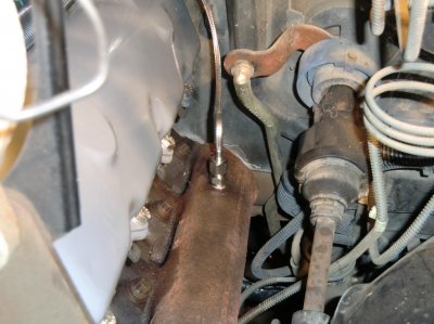

Probe is in
I finished last night around 1:00 am. I did center punch. That was before I read the post about cast iron being so brittle. I couldn't hit it that hard anyway because there was too much stuff in the way.
I tapped down until there was 4-5 theads showing on the tap and cleaned the hole out with a small bottle brush. I don't have a turbo, so the shavings will go to the muffler.
The pyro adapter went in with a little antiseize and is a tight fit with 3 threads showing.
I can't wait to fire it up, thanks to all that posted tips. I really appreciate your advice.

Nice job! That is clean and a good install. I agree with the antisieze. Even if you never plan on removing that bung, at least you know you can.:D

Nice job! Did you drill with only one size bit, or did you use multiple bits?

I drilled with a 1/8", 3/16", 1/4", then with a 21/64" (which is .011" smaller than a "R" drill bit). I couldn't find a hardware store that had a "R" drill bit and I had a sharp 21/64".
I have always had better luck and cleaner holes drilling a small pilot hole then working my way up to the desired size Then I tapped using Rapid Tap fluid.
