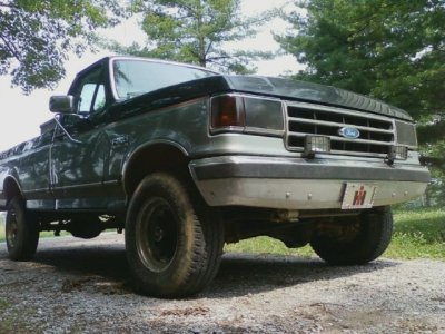

Alot of you younger folks might appricate this lol. Kids like me these days cookoo I taped the chrome on the headlights up and masked off the fenders, hood, and bumper. Then I sprayed it with VHT Nite Shades paint. It looks real good and it set the front of the truck off. What ya'll think?

im younger and i think that stuff looks like crap it just scratches and peals off all my buddies use it and the reapply weekly but the stuff pros use coats evener and looks better over time now that looks good
btw make sure its legal down there on headlights here youll get busted big time

yeah its leagal... done checked. And I used run one of my old F150s through the woods alot because I **** hunt. It had tinted tail lights and headlights and it never scratched or peeled. Sounds like your buddy didn't clean the lens up good before he started sprayin :dunno

i wouldnt dout it but hes in woods daily too and beats that truck like mad

That doesn't look bad, but I thought it would be more glossy. I always wanted to try that stuff when I had my 2000 mustang, it was pretty popular with that crowd. I dont imagine the light output is affected too much. I had a 95 F-150 and bought those full blackout covers that fit over the entire light assembly. At night I could see well enough to drive but they did make a noticable difference. I went to visit a freind in another town and he told me to remove them or I'd get pulled over. We didn't even get to the end of the street before I got pulled over. Thankfully they snapped on so I just popped them off and he let me go without a citation.

if ya bump yer headlight wattage, its counter acted. 100/130's are $25-30 a set.....

When night shades first came out I used to sell a crap load of it. The stuff works great but the trick is that you are supposed to spray it on the back side of the lens,not the outside. Take everything apart,clean well and only spray a very light cote,when you do it that way it causes a shadow affect, yet lights are almost unaffected!!

Yea....problem...you bump up the headlight wattage your going to need a good fire bottle.....The stock setup already burns up the wiring harness and headlight switch.....
