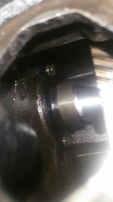

I had my mechanical pump off to install block plate, i meant to stick bore scope in and see if you could see timing marks. There was oil on my cell phone lense sorry for the blur.
