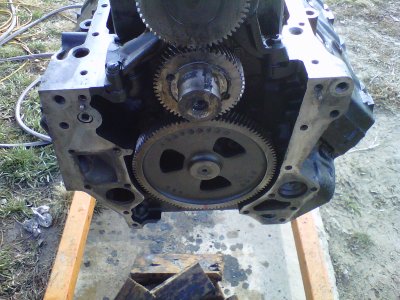

Okay I went through the pics on my phone of when I had it all apart and it appears that even though I didn't touch the cam or crank gears someone has had it before because it doesn't look like the dots on the 2 gears would ever line up. I guess my plan is to try and retard it 1 tooth from what I had today which is where I thought I had it but not sure it might have slipped a tooth when I put it together the first time and maybe today I advanced it 2 teeth? I don't think theres much room for error so it would have to be back 1 tooth. Could the cam or crank gears of been put on by someone before me in the wrong direction or is there only one way they can go on? It all looks about 90 degrees off of where it should if I tried to set it up correctly. I counted out the 19 teeth from the y mark on both sides and made a straight marker mark across and then one straight up from the y and was going to install it but theres no way it could be a whole 90 degrees off from where I had it good enough to run before?

Okay actually I really studied that picture and the engine is upsdie down but if you look at the crank gear where the dimple is and count to the left and then look at where it meshes into the timing gear and count around where it would come into contact and I think I see the y mark so it would line the y mark and the dimple up which would be 180 degrees off and then another revolution and both dimples should line up and I would be able to put the y marks together from the cam to injector pump. I just can't figure out why when I put the crank line at the 0 timing mark it shows the timing gear being turned about 90 degrees from where I had the engine running. Makes me think that its not really TDC when its at that mark.
