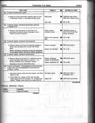

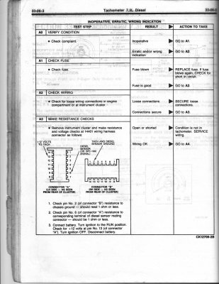

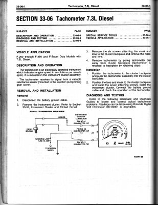

338
The tach sensor generates a very low voltage at idle, as the RPM increases so does the voltage IIRC max is about 5 volts. It could be that your connector from sensor to harness is corroded, if it's corroded, that is a resistance.
