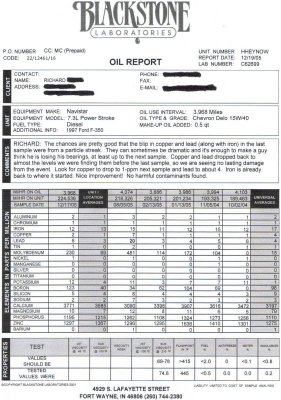

Fishawk, read THIS THREAD of mine from the BITOG forum. I'd hate for you to go through the same experience as I did last summer. The Blackstone link in that post doesn't work so I attached the following report here for your scrutiny. Notice in the 218,236 mile report the elevated lead and copper.
Heed what 95_stroker said. If it ain't broke...leave it alone.
