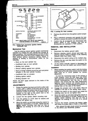

Thanks Icanfixall, I bought a new lock cylinder yesterday and will replace that. IIRC it is as simple as turn key to ON position and use paperclip to push up on the recessed pin under cylinder and pull the switch out?

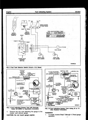

I have some new fun, ran it out of fuel yesterday. It seems the switch for the front/rear tank has an issue. It pulls from the front tank when switch is in front tank position, but shows fuel level of the rear tank and vice versa. Is this something on the front/rear switch backwards? I know the previous owner had the dash apart while replacing the headlight on/off switch, could he have reversed a couple of wires? Now the rest of the fun for the day is purging the air out of everything.

Air is purged and it back to itself. I haven't done the ignition switch yet. Here is what I found, when the switch is set to the front tank, it reads the level in the front tank, but is pulling fuel from the rear tank, when set to the rear tank, it reads the fuel level of the rear tank but pulls fuel from the front tank. The problem is not in the dash but appears to be at the tanks. I can see where it has been rewired in the past and the dash wiring is original. I think I am going to pull the bed off and correct it. It will work out as I have a hitch to install as well. I scored a stock one from another F350 for $75, with mounting hardware.

342
To help you straighten out the fuel tank FU wiring.
Also how to adjust the key switch.
