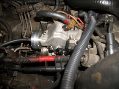

well i thought about installing my h-max smoke puff limiter but i only had time to change the knifes in my chipper after work today dangit.it's the thought that counts anyway though right?:rotflmao
ah well.maybe tomorrow.im hardly getting smoke anyway really.just when she hangs in OD pulling a grade (with ease!) and just as she downshifts to 3rd she gets a little dirty.

well i got 'er in today after work.now to figure out where to tap in the boost line.instructions say pre-intercooler. i was thinking about that the other day,cus i thought it might not be responsive quick enough if it wasn't tapped in at the turbo.
hmm.just in the wastegate line maybe? i'll search to see if i can do that,then start a thread to ask if i come up empty.otherwise i guess iv got to tap into the cooler pipe just as it exits the turbo i suppose.
i started her up and she didn't run-away on me,so that's good for starters.:D
(i did keep playing until i figured out how it could look if installed wrong.-basically it can hook around the throttle linkage in there if not careful i noticed.)

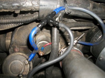

plumbed in my SPL tonight after work.they dont supply the 1/16 Allen wrench required for the set screw.:dunno so had to run back and forth from and to the hardware store.couldn't get the right one because someone put a metric in the bin i guess.oh brother.finally got one at another hardware store.
so anywho,i called h-max and they said if the wastegate line is before the intercooler i could tap in there without issue so i did and then i followed the directions to turn it until the engine idle starts to lower,then turn it out a full rotation and then test drive to dial it in.
oh man...........it's not just no smoke in OD before she downshifts to 3rd but it's quicker acceleration (like a lot too!) without it rolling coal.this little gem is a power increaser! not just an efficiency booster.
so it was getting a little dark,so i'll wait until tomorrow to dial it in some more.it's so stupid simple to tweak i love it!
this bull moose ip is impressive but now coupled with the SPL it's like holy crap.best of both worlds!fun stuff!
