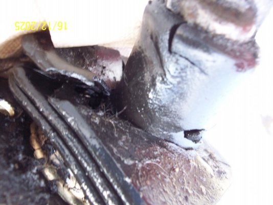

After work, it was such a nice day , over 60 and the wind had died down to almost nothing, that I decided to do something with the gallon of synthetic ATF that's been sitting in my house for over a month now. The engine doesn't have to run to change the fluid in the ZF5. Yes. It was past time to change it. It was on the dark side. I'm glad that I prefer to cheat and take the top off of the transmission to put the fluid back in. The boot that goes right on top of the shifter stub, not the shifter boot on the long, upper part, has all but disintegrated. Does anyone know if you can buy new ones? Overall, it only took about 45 minutes. Not too terrible. I'll also bet that the transmission will shift a little better again.
