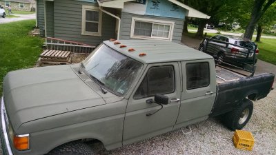

Finally have the cab completely in primer. Still need to take the step off the truck since it's the only one on there.
I'm not messing with the bod until after the 4th July weekend

Wow it's looking Nice looks like your hard work is starting to pay off. ;Sweet

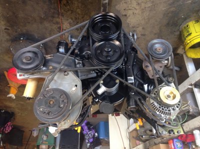

Added my accessories to the engine (waiting on ARP bolts for the intake) hoping to have the engine installed this weekend.
if the photo is upside down my bad.:dunno
