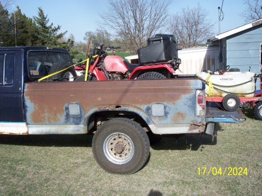

I finally had to go get my spray rig to spray my yard. Between wind and rain, I just hadn't gotten around to it this year. Now for the difficult part. Somehow, I got into some ethanol gas despite my best efforts to avoid it. I had to clean the carb. The float bowl was full of water. In fact, I could barely smell any gas. I was already draining the tank by this point. I'm lucky enough to be able to remove the throttle cable, loosen everything up, and rotate the carb far enough to remove the bowl without pulling the carb off. It only took me about an hour to get it running again.

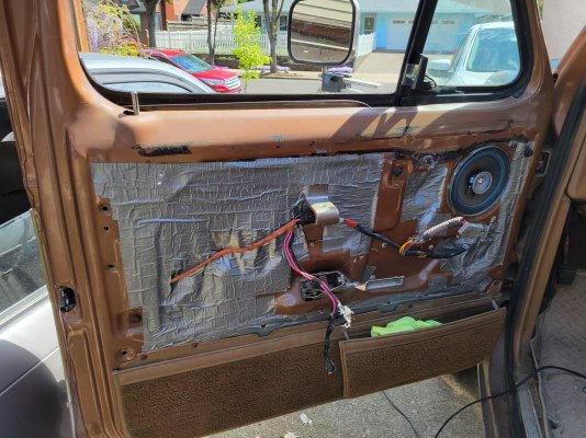

Went to get a load of compost for the garden. While there the drivers window rolled down and wouldn't come up again. Pulling the door panel showed this marvel of duct tape weaving protecting the failed scotchlok splice some previous owner made to replace the power window motor. On the bright side, I didn't have to order anything and just fixed it by putting in a decent splice. Next I need to figure out why my parking brake pedal won't stay latched.
