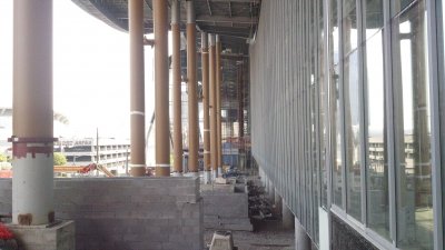

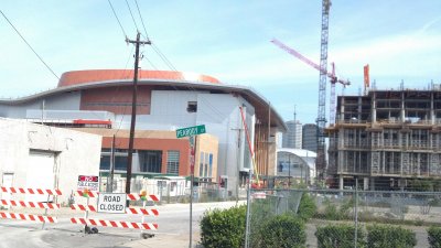

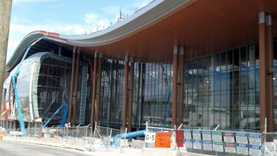

I was in Nashville, just for that summer, to work on the new Music City convention center. Pretty big, eh? Three city blocks and at the time, it was the biggest job site in twenty states. It was actually 7 stories tall, if you count the multiple parking and basements underneath.
I worked 2nd shift on the high exterior ceilings using a boom lift reaching almost 150 feet up in the air... :eek:
Whee! I watched the July 4th fireworks from way up there. Pretty cool.;Really
Here's some pictures... Enjoy
attachment.php
attachment.php
attachment.php
Ok, back from the thread drift.
This is where I was working 2nd shift, when it was already 105 when I left the house to start the 3 o'clock shift (that sounded weird). By the time I drove a few miles to the job, my A/C was blowing a chilly 45 degrees from the vents on full blast! That's a 60 degree temp drop! I don't think R-134A can do that! Heh!
