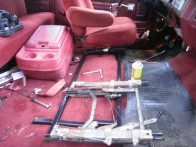

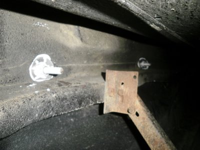

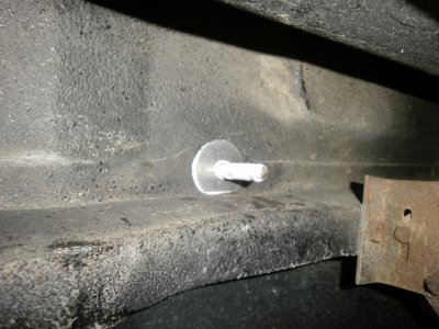

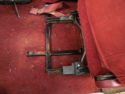

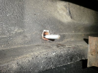

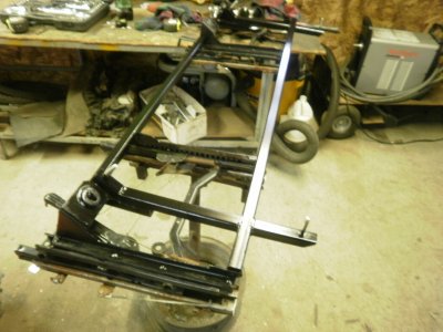

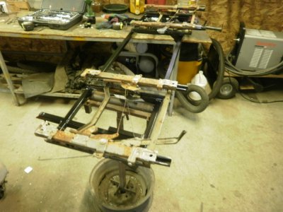

Here is the frame after paint. I didn't bother with cleaning off the tracks because, well I didn't bother. The only reason they rusted to begin with was the fact that the truck donor was damp inside. The fabric and foam was damp and that retained the moisture enough to rust the unpainted steel. Generally only the lower roots of the seat frames rust where they bolt to the floor due to poor sealing from the factory. In this case, they had a light zinc coating on them in that area.
The frame is very hard to see once the seats are installed, so I also took a shot of the driver's side dropped on.
(sorry about the blurry image - my camera seems to be picky about twitching when holding down the shutter button)

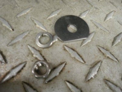

To attach through the floor, I went out and bought some stainless steel lock washers and "fender" washers. Since I didn't use nylock nuts, I didn't want the nuts to loosen after some use, so the lock washers were some extra insurance. The wide fender washers were to close off the rather large hole left in the floor by the OEM mounting nuts (which are VERY prone to rusting solid after being disturbed - if you can even get them to give up), but also to spread the load nice and wide against the floor sheet metal.
The washers turned out to be slightly too wide against the floor stringer, so I used the benchtop sheers to trim them down a bit.
Next came the ProForm PF211 urethan sealer on the side of the washer going against the floor. This way there is no risk of rust getting in through here and with any luck, I won't get any creeping corrosion on the seat frames either (ford really should have used sealer from factory, but I digress).
The urethane is among the best I have been able to find so far since it is UV resistant, perminantly firm and flexible (harder than silicone, but never gets as hard as regular seam sealer), will bond to just about anything, and doesn't shrink as it cures, so there is no risk of cracks forming of sealing a seam joint. Here its an overkill though....just the way I like it
The washers flexed a little when the nuts were torqued into place but I'm fine with that since it spreads the load that much better. Also note how the sealer oozes out from under the flange, which should keep the moisture out.
Again, appologies for the poor quality, but it was pitch black before the camera flash went off, thanks to the sun being gone for about 3 days now-cuss

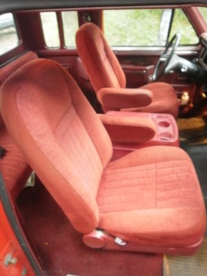

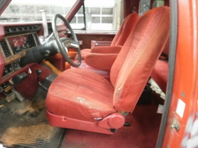

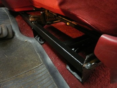

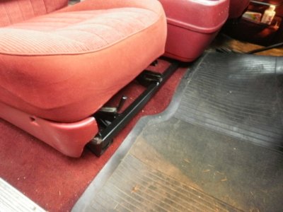

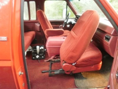

Finally, I can show the interior.
The frame is hard to see with the seats in their upright position either in front or behind, but what is visible looks clean.
First picture is below the front of the driver's seat.
Second picture is below the front of the passener seat.
Third picture is behind the passenger side seat with it moved fully forward (this is what you would see if climbing into the back while looking down).
Looks pretty much OEM even though its technically out of a 1991(ish) pickup or bronco, not exactly sure if there is a way to tell for sure.
Aside from being comfortable for the front occupants, I really like how far forward the seats slide forward making it probably the easiest extended cab truck I've ever seen for rear seating access (short of having an extra door).
The driver's side isn't in perfect shape as you can see in the last photo, but its still very comfortable and I may have it redone eventually. Got one quote today and will likely never go back there again LOL (over $500). Another guy says he will get back to me if he can locate the fabric, but I've already found potential sources online for raw fabric or completely new upholstery (sent Email and waiting for reply) and the offer free samples to verify correct match.
Also took the truck for about a 2 hour drive today and wasn't sore at all by the end. Maybe a little sleepy from being a little too relaxed, but not sore at all.

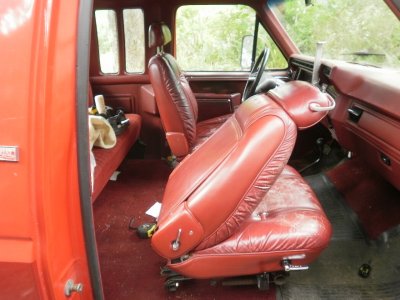

The last two photos are a quick before and after to show the difference in how far the ford seats move forward thanks to the compound track setup.
And that should just about do it. I still have to get a latch for the console but other then that, its basically done.
