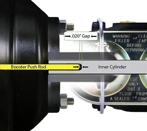

You can make a tool out of a cereal box and a set of calipers. Though 1 inch would be pretty darn close.
2,401
2,541
Here is this nifty Booster/Master Cylinder rod adjustment tool.
I bought one a few years ago, and used it last week when I was doing my
87 - 91 Master cylinder mod on the 86.
pretty cool how it works.
Here is one site selling and explaining how it works.
Do your searching, they are cheaper and pricyer depending who is selling them.
EDIT:
Just noticed back in post#7 I already posted this, with a YT Vid
from another vendor....OH Well...

Turns out the booster rod was a touch too long! I'd say only a mm, but I'm sure that makes a difference.
Thanks for the tip on the tool, got me one and for one thing it's way bigger than I thought, but also terribly useful! It was only about a 20 minute process including finding the right tools. That adjustment nut was TIGHT.

There are tiny holes in the bottom of the reservoir of the master cylinder. Those are the ones that spit up brake fluid if you hit the pedal fast with the master cylinder cover off. This is less apparent on the plastic reservoir models. Those are called "compensation ports". When the brake pedal is up, those ports lead to the brake lines and the calipers and wheel cylinders front and rear. So the whole system is "open" to the reservoir when the brake pedal is not pressed. This allows for expansion of fluid in the system and gives it somewhere to go.
When the brakes are applied, the very first thing that happens, these ports are covered up so pressure can then build and apply the brakes. If the rod is just a little too long, it will cover up these ports. All you have to do is take it for a drive and it doesn't take long for the fluid to warm up and start expanding, and since it can't go back in the reservoir, it will start applying the brakes slightly.
