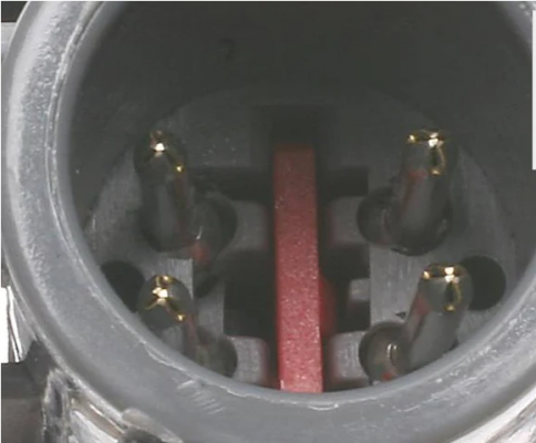

Thanks for all the help with my brake/hazard/backup troubleshooting at the fuse box.
I now have brake and hazard flashers working. But still no reverse lights.
No power at the sockets.
I'm guessing next place to check is the switch on my C6 tranny? How to test that?
I found this pic of the connector online.

I BELIEVE that you should be able to jump the terminals, on the pigtail for that switch, and determine whether or not the switch is t/u or that wiring is your issue.
If I remember correctly, with the ignition “on” and the terminals jumped, you’ll get reverse lights on if you’re wiring is good….so that would lead you to a failed switch diagnosis.

Thank you both. I jumped the black and purple terminals going to the pigtail and got voltage when in reverse. So I know I'm good up to the switch.
I guess I'll replace the switch.
There's grime/oil around the switch. Do you know if there's a tranny seal I can replace while I have the switch off?
