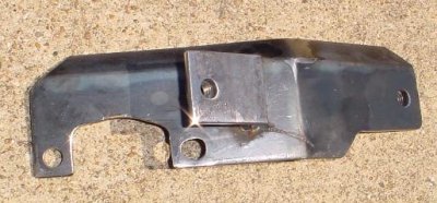

Here are the photo's of unpainted bracket to mount the racor next to the master cylinder. The thin grey lines on the drawing are grooves cut in the back side to 75% depth to allow for bending of the steel. The grooves were mig welded after the bracket was bent to shape. The cutout for the master cylinder is not exact and may need adjustment. I found over an 1/8" difference between the old and new master cylinders. The slotted hole for the master cylinder has no purpose other than correcting a mistake measuring.
The mounting holes for the Racor unit are not on the drawing since these were marked and drilled using the unit as a guide. The small bracket for the left side was made from 2" angle and was cut and drilled to fit.
Nuts were welded in place to allow quicker and easier annual r&r during filter replacement.
I did not measure the angle of the main bend. I bent it on the truck so that the inlet hose would just clear the front of the master cylinder.

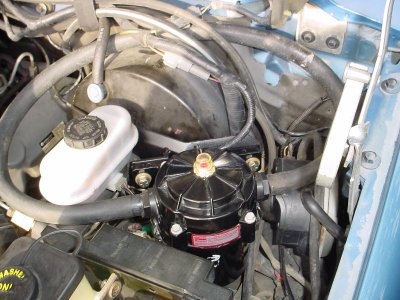

Here are the pictures of the Racor installed with a temporary hose. A preformed 3/4" heater hose with a 140-180 bend would be nice for the outlet.
The wiring harness to the master cylinder passes between the bracket and the Racor unit. The cruise control cable passes between bracket and the brake booster.
Also the cruise control unit bracket has been modified. The factory bends were removed, 2" added the bottom so an additional hole could be added. The factory lower mounting hole is now the top. This created the needed clearance for the return hose. Also I twisted the mounting bracket slightly toward the front so the cruise cable was not binding on the power brake booster.
The vacuum canister still needs a new home.
