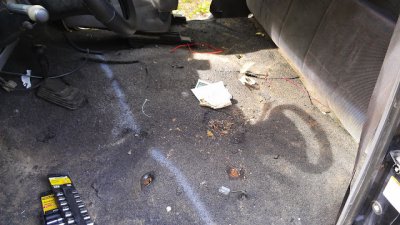

First things first, CLEANING
The interior was, well not there. The PO has stripped the carpet and had an asphalt mat, W.T.F. over?!?! I stripped the interior...
Then stripped and washed the floor pans
Sanded, wired wheeled, then Line-X all exposed metal. It's been 3 weeks, and all of the crap is off my skin now...:mad:
