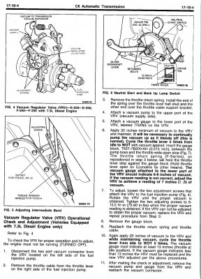

Doing some research on the internet, it looks like the C6 trans is supposed to have a black striped modulator for diesel applications. But I'm not sure if this is correct
342
IIRC The black strip modulator for Diesel's.

Thanks for the diagram Oldbull. This is what the trans builder is using to adjust the VRV. However, I am not so sure this is the problem. Might give him a followup call tomorrow and see if he can install a black band modulator and see if that solves issue. Maybe it's that or the internal governor in the tailshaft housing :dunno.
