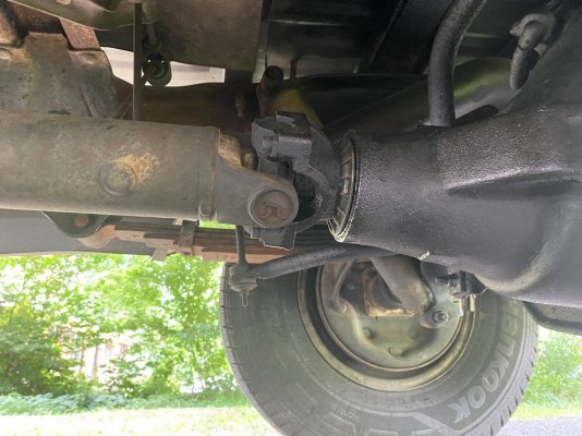

so after driving about 25 miles with newly added differential oil i checked my truck and its dripping from the actual u joint? i figured it would come out of the seal to the right into the diff case. i'm not exactly sure how to proceed do I still need to replace the pinion seal or is this a different part that needs replacing (u joint)
it's possible the diff oil is just dripping from the ujoint depending on terrain, but there's grease/lube in the u-joint too that could be 'dripping'. when doing the pinion seal i also relplaced that u joint as well since it was worn (and maube a cause of the pinion leak? who knows).

There are only two items connecting to the u-joint; the driveshaft and the rear end. The rear end has lube in it and the driveshaft does not. Not too hard to guess. It looks like the pinion seal may be bad.

yeah when you put it like that it makes more sense, also the ribbed looking cover over the rear diff case that the u joint is connecting into can spin freely with my fingers spinning it. Is that normal or showing that its loose?
That's either the seal of part of the seal that's no longer attached. Either way, I'm pretty sure that it's not supposed to spin.
