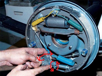

I had a similar problem with my 65 mustang, the rears would lock if you sneezed on the pedal. It turned out to be the shoe springs and hardware had died.
As for the self adjusters, I've not been into the brakes on a dana or sterling. However on my mustang there was a paddle that locks grabs the star gear. When the paddle pushes the star gear down, the adjuster should unthread. (get longer) if it screws in, then it's the one for the other side. (photo to try and help my bad explanation)
Photo from http://www.mustangandfords.com/techarticles/suspension/mufp_0704_brake_system/photo_16.html
