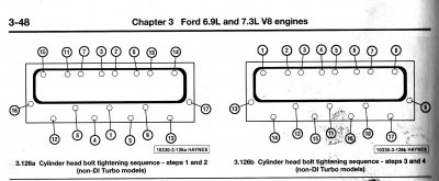

If it's still there in the Tech Articles, "Know your 6.9L and 7.3L History" this is what it say's about head bolts for the 7.3L, "Head bolts torque to 100 ft lbs new or used".
I've personally torqued them to 120 ft lbs, after the original torque sequence to 100 ft lbs., then in four (4) 5 ft lbs steps/sequence.
