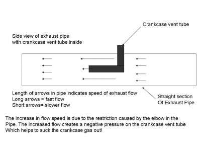

I think the best bet would be to put a 90 degree bend on the nipple for the crankcase vent and position it so that the crankcase enters the exhaust in the center of the pipe. This should create a venturi effect because you have in a sense created a smaller diameter exhaust pipe which will increase the speed of the exhaust flow around the elbow and cause a slight vacuume effect on the crankcase. Hard to explain see illustration!

I think he has it about a foot from the end. I am quessing that is rear spring mount in the top of the picture.
You could help it even more if you did a transition to a larger pipe at that point.
