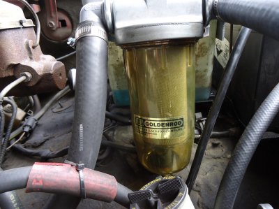

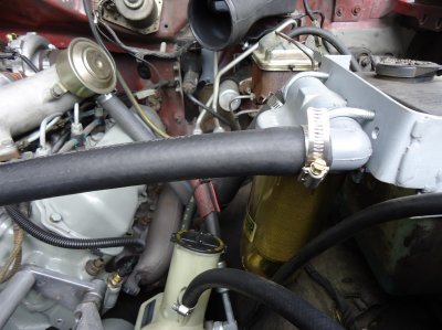

I made this catch can with a Goldenrod filter. A stainless strainer is available to replace the paper element. I have a Banks adapter at the oil fill and from the filter it goes into the intake between the air filter and turbo using the CDR.
