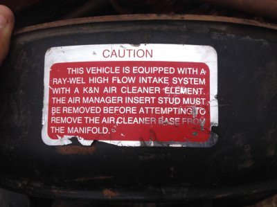

So the 85 Has a Ray-Wel HighFlow Intake System Says it comes with a K&N filter.
Is this kinda like a Banks PowerPack? Does it do any good or about the same as Stock?

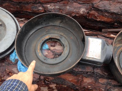

The one I'm pointing two is the stock with soup bowl removed.
And bs here's the Ray-Wel it indeed looks like it can fit a bigger filter than stock.
And it has a soup bowl.

Sorta I suppose it is just the aluminum part that smoothes air into the intake manifold along with alledged good KN air filter...toss the KN get a premium Napa with the sock prefilter ...platinum series I think and yer golden.

Is the k&n filter stock size or bigger I thought it was a larger filter was part of the point of the lid
14,782
492
Are you talking about a filter BASE or filter LID...the lid upsode down appears stock doesnt even have a soup bowl mod done...but cannot tell for certain with out a comparison photo of stock one beside it.

Only thing different I see is that center piece thing on the base.
Measure the depth on both and compare. Seriously look the same to me.

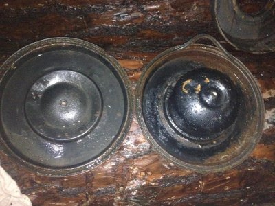

Since you Asked Al
Lid on left is stock with no soup bowl right also looks stock with the soup bowl.
