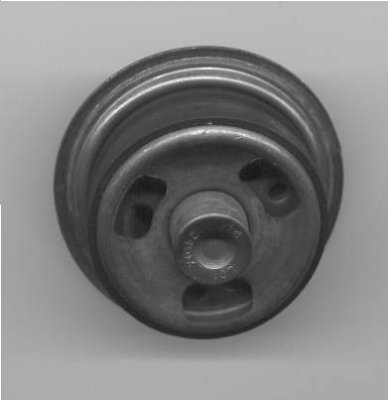

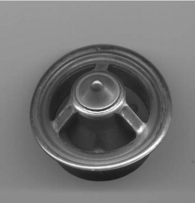

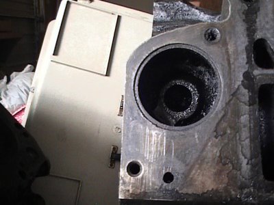

The way your heater hoses are hooked is correct. There is a fresh air door operated by a vacuum motor next to the firewall under the hood, make sure the vacuum line is hooked up and the motor is operating. As Riot said, pull the t'stat and make sure it's a Motorcraft or an IH one. This (pic) is the only configuration t'stat that should be used. The copper slug closes off the bypass hole, shown in pic of t'stat mounting. It's important that the check ball in the t'stat neck is there and free, should rattle when shaken.

I didn't say the t'stat should rattle, it's the neck you took off to replace the t'stat. Look at the side that bolts on, there is a little hole with a ball bearing in it, shake it, it should RATTLE.
