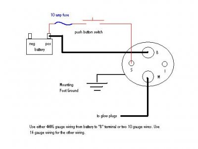

here is a little ditty I just threw together... hope it explains it better.
Now the glow plugs will pull much much more than 40 amps that is why you use a relay. So that you have a remote controlled switch per say... the high amperage stays under the hood and does not enter the cabin of the truck.

THANKS thats a huge help. So its basically the same concept as a ignition switch to engage the starter relay; then it egages the starter. easy enough.

That's WAY overkill on a switch to energize the relay, but better heavier duty than too light. The push button is only applying power to the switch terminal of the relay (solenoid) which probably doesn't draw 5 AMP's. Sound like you got it figured out. The solid state system is somewhat of a different beast, hence why everyone was asking you.

The 84 already has a perfectly fine relay, you just need to wire the pushbutton to it. All the controller on the 6.9 system does is switch the power to the relay, no more, no less.
If memory serves the wire you need to hook your switch into is purple. It's one of the small terminals on the relay, the other one will be black and go to ground.
