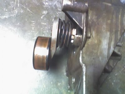

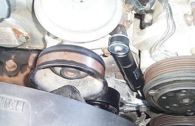

How about starting out by identifying your tensioner assembly?
Here's three pics. tell me which one you have.....
note the "body" of the tensioner.

here's the thing guys...
the truck came from the factory with the tensioner like the one in the first pic. how to tell? the spring is exposed. The updated ones is the pics in two and three. But in order to make it work, you need to buy the bracket it mounts on. I have done mime already and the part numbers is in the "parts bin" in the tech articles. The third one with the dampner shock is a nice idea, but very expensive and masks a larger problem. If the tensioner is dancing around, you have a bent pulley.
