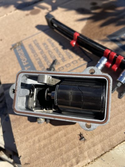

Here is the problem! Pretty sad that it only lasted a good 10 mins of driving/ idling.
