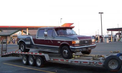

New F350 purchase - but its' an automatic - advice on servicing the tranny please ?
I just bought another truck
1991 F350 w/7.3 IDI - ATS turbo - crew cab
160,00 miles
Same owner for (11) years who babied it :love:
He could of been my brother ....
Only thing I don't care for - automatic tranny :dunno
It has a 4:10 rear end with a FOTZ*7V00*LRM automatic
with overdrive button on the dash - transmission was replaced
60K ago in 1999 by Ford along with processor assembly, tachometer sensor,
tripminder assembly.
He added a tranny cooler with a dash mount temperature gauge.
The shifts are hard & quick but that is without any trailer
or towed load.
I am planning on having the tranny completely flushed, filter changed,
fluid replaced before putting it into service.
Would you recommend draining the tranny, installing a new filter
and fluid, do a complete flushing, drain a second time and put in
a second filter ?
That is what I am planning to do ...
Also, what tranny fluid to use?
I like Royal Purple diff oil, I run 85/140 in my 4:10 rear end
on my 1990 F350 now so I was thinking of maybe putting
Royal purple tranny fluid in .....
If you don't know - I tow ;Really
Thanks!
Jim

No need to farm the job out. Changing transmission fluid is fairly easy. I've done it in my driveway. The instructions have been posted, long ago, but I lost track of that. I have them in a word doc, a bit long to paste in here. I can PM them to you if you'd like. They're labeled as being for a '99 Superduty, but the process is the same.
At the same time I'd suggest changing the filter, and changing to a deeper pan on the E4OD, one with a drain plug.I have part numbers for that too.

i would add a secondary filter, perferably a simple remote mount oil filter style. those in pan filters are more like screens with a pick up tube.
i second the deep sump pan/one with a drain plug. while u are in there, make a little clip to hold the end of the filter furthest away from where it goes into the valve body. sometimes the filters wiggle loose and cause a sluggish-then-hard or no reverse.

This one has the deep tranny pan w/ drain plug, a tranny filter with
rockguard installed under the truck, supplemental cooling fan at
the radiator, coolant temp gauge.
I really want to completely flush the tranny out - the only way to
do that I know of is by a power flusher at a reputable shop.
Also, what do you guys think about Royal Purple tranny fluid?
