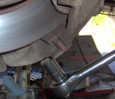

FWIW the 1984 trucks are a bit different than the later years, in that there's no rubber piece in the assembly. It instead has an all-metal "key" that looks like a small I-beam (with one channel surrounding the mount and the other channel surrounding the bottom of the caliper), with a metal flat spring that goes between the key and the caliper itself. The retaining bolt fits inside a notch cut into the I-beam channel.
With that said, the removal procedure's very similar to the rubber-encased key assembly used in later years. Once the retaining bolt's been removed, you'll need a hammer and punch to forcibly remove the key. The FSM picture's showing a person hitting it on the inboard side and pushing it outboard, but IIRC you can go either way. The spring is a separate piece from the key, so make sure you don't lose it when it comes off!
FWIW, my FSM doesn't say anything about needing to replace the key or the spring. I don't know if you could substitute it with a later rubber-encased key assembly or not, but I don't think there's any reason to.
Hope this helps some...good luck!

For some reason, the "Go Advanced" in the "Edit window didn't want to work, so I'll just add another post. I found a few pictures of the key-spring setup that my '84 has. Hope this helps ;Sweet

and when you take it apart, put a new flat leaf spring in there--after soooooo many times of being hammered on in reverse--the tension decreases---
