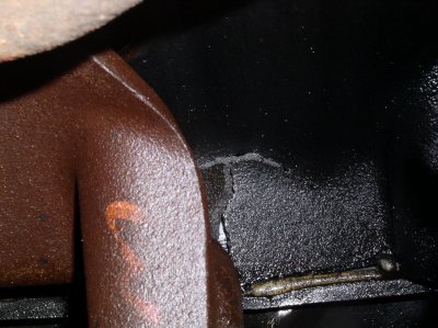

Well it's home & I will try to get some pics of what I see so far.
apextrans
What Log Book????
Jan 9, 2005
1,615
Fallston, MD
Here's some pictures. Not great but I'm shooting through the space in the fender liner & the shock.

RIP, no further diagnosis needed....:eek:....Time for a longblock I would say.....Which # cylinder is that? Hard to tell in the pic's....Funny coincidence but I was visiting with my buddy who is a service advisor at the local Ford dealership today - (his wife just had a baby last week). I mentioned reading about your truck on the net....He asked about chips, turbo upgrades and etc.....When I said "yes", he wasn't surprised.:dunno....He was telling me MANY horror stories about the 6.0L's and diesel E40D/4100R tranny's....6.0L Head gaskets and tranny failures are a constant site in their shop, he said they can't get the $7000 tranny's in stock fast enough lately.:eek:
