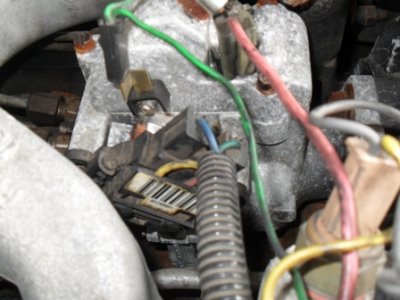

Everything on the engine looks mechanical. The IP doesn't look like an old D-B2 ro me though. Which spade on the pump is the fuel shutoff?

If everything is mechanical then you won't have an ECU. They're on later model turbo 6.5's. The spade for fuel shut off is on the left (looking at it from the front of the truck) of the IP. Close to the radiator. Red wire in the picture. If you put 12V power to it, you should hear an audible "Click" of the solenoid opening. If you don't, then the shut off solenoid is bad.
