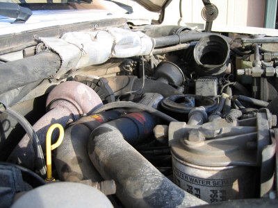

towcat asked that I post some engine pics. This is our son's truck, which I'll be selling real soon. It's an '88 F250, 4x4, extended cab XLT Lariat. At some point in the past it's been retrofitted with a complete Hypermax turbo & intercooler system.
Sorry, this is the only pic I have right now. If you'd like to see more or anything specific, post up and I'll take more pics and post them.

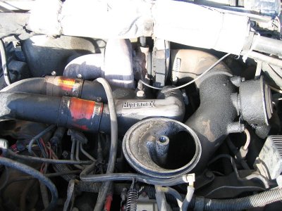

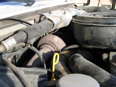

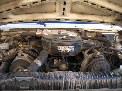

By request, here are more pics of the Hypermax install on an '88 F250. The first is from the front showing the turbo & hoses to the intercooler. The second is from the passenger's side showing the same, along with the hose to the cowl induction. The third is from the passenger's side with the air cleaner on. There is really no way to take a pic of the intercooler with where it's installed.
