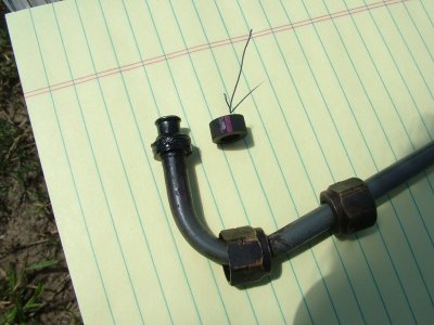

If you just replaced the IP with a Moose unit then you have to have removed the hard line between the IP and the fuel filter. I'll bet money that the olives in there, at both ends of that hard line, are old and brittle. It leaked as soon as you disturbed it. It was no longer able to seal because it could not adapt itself, reshape itself, when you put the line back on. You need to replace the olive at each end of that hard line. That's two olives.
You replaced the IP with a Moose unit. Give Mel a call. I'm pretty sure he'll be happy to sell you some olives.
Once again, here is a picture, posted here a number of times before, of that same hard line, with both the old olive and a new one.
attachment.php

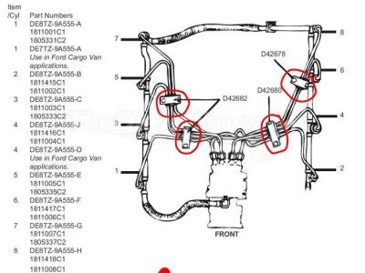

There is no Olives in the injector hard lines. You may have a cracked line if it's still leaking or it's cross threaded , hope not. Did the lines have the clamps on before or now? This is how the clamps should be.The lines have a tapered end to seat.
