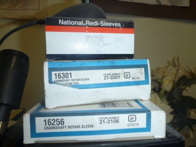

one thing that has been forgotten. diesels have a tendency to "vibrate" themselves to death thanks to the compression pulses. on a high mile motor, it's guaranteed the seal surfaces are grooved and are in need of a new "surface" before a replacement seal is installed you'll find the part numbers for these seal "sleeves" in the "parts bin" you should install if you're putting in a new seal.
682
I agree with what towcat has just posted. Not installing a repair sleeve is asking to do the job again. I actually feel sleeves should have been installed from the get go. A wear sleeve is designed for just that. Wear but the part is saved. Whats more expensive. The sleeve or the part.. HMMM...:angel::D
