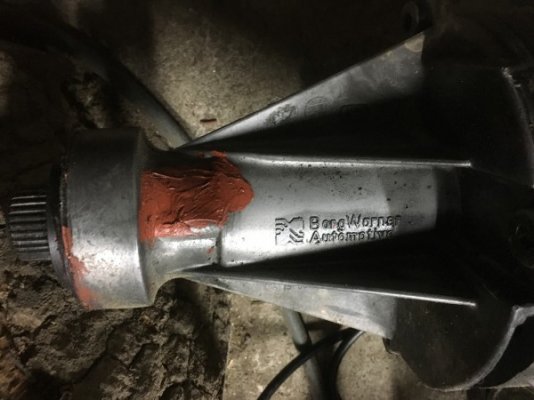

Hello,
I already noticed this about 15 years ago, shortly after I bought her, when my truck came home, but due to registration issues and so, I hardly ever used her.
and now I got the tranny underneath for a overhaul, and I thought while I'm at it, what shall I do wit this?
You must know, being in FRANCE It's very difficult to become spare parts for these trucks.
Please tell me, what do you think it is what you see at the photo under the orange goop????

Does that transfer case have a hole for a speedometer cable? If not there’s probably a crack.

yes it does, and I also think it's a crack, but I'm not sure, and I don't want to get the goop off to look, while it is quite decent stuff, well done.

This will be from a crack repair. this is popular for off roaders using some quick set RTV. Problem is that quickset isnt usually very good with oils or high pressure for a long time. If it were mine I would absolutley scrape and acetone all of it off. If you have a welder or know someone who does, use a 6010 stick and seal it up. 6010 rods dont care about dirt, oil, rust, grease, nothing will stop it.

No way to tell what you are dealing with until you remove the goop. Black RTV will seal it back up if you have to run it for some reason. But you want to get it fixed.

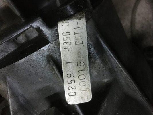

That is the very common BW1356 tcase, and that tailcone isn't doing much at the end except holding a seal.
If you're really curious... take off the silicone. Can always silicone again, or step up to a metal-epoxy putty type compound (JB weld, etc.) I don't think its worth the trouble of welding. Many of these cast alloys don't weld very well - especially after oil exposure.

That might be feasible, I'm just curious what they did to it, to get a crack there?

BW 1356 transfer cases are magnesium. The red sealer could be sealing a crack or pinhole leak. The seal is held in the very end however in the area of the red sealer is a bushing that supports the driveshaft yoke. I have seen tailshaft housings for sale on line for more money than I paid for the whole t case. Might be a good idea to check ebay. Used t cases go for $100 to $150 from what I’ve seen. If you just have a pinhole leak, just clean it up, sand it and use JB weld or something similar. If it’s a crack, seal it back up, keep an eye on it and think about a replacement part.

though I'm on the other side of the pond here, and I'm not sure if A) someone selling on e-bay likes to sent it over, and B) Imagine all those costs for "just a pinhole"?
I mean; if it was something structural, that would be a different thing.
Are these t-cases known for developing holes and cracks in this spot?
