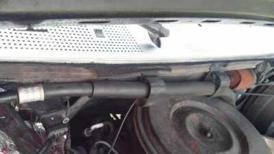

Well, I finally got around to installing that seal this evening... In the picture of the old one, you can see that it was shot to ****. It was really brittle and not much of the flange remained.

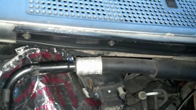

After I installed the new one, I didn't like the way it fit. There were some spots behind the seal where it pulled away from the cowl and would allow water to pool on top of the air cleaner. So, I decided to use real silicone sealer where the cowl meets the seal. I used clear silicone that was waterproof in 30 minutes. It was also tack free in 30 minutes, which is why I used it. I didn't want to leave the hood open all night.
Anyway, I applied a 1/8th bead of chalk from one end to the other, on the top and spread it using a Popsicle stick.
attachment.php
Tomorrow, I'll redo the vent temp test again and see what happens...
