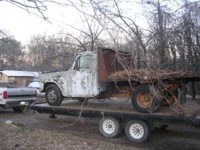

I brought home a new project today.;Sweet
I don't know a thing about it. It has a 2 barrel v-8 and a dump bed. I really just bought it for the hydraulics and bed but am out trying to get it running now.
The woman I got it from said it just quit.....in 1995. So far I can tell that they put new cap, rotor, and plugs in it. The points were fouled and I got them working, but I can't get it to spin fast enough to come to life on ether. I pulled all the plugs and put PB blaster down the cylinders to loosen up the rings. I will try to spin it over again tommorrow.
Does anyone know what the point gap on something like this should be? As I mentioned it is a 2 barrel v-8 and I am guessing a late 60s or early 70s model.

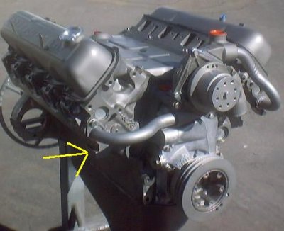

If you look on the passenger side of the engine under No 2 exhaust port there is a flat boss with the engine size stamped into it. *Some times "345" will be cast on the cylinder head under the valve cover. Also a trained eye can tell you if its a 304 vs 345/392 by the size of the coolant buy-pas hose

I just went out to look, but in rereading your post I was looking in the wrong spot. It has "353" cast into the head below the number 2 exhaust port.
The coolant bypass hose looks like 2". It is ridiculously large.

hmmm ok well with the water tube its more of a leangh thing then a diameter measurement. The stamp can be found on this BOSS its more below and off to the side of the port lol... is a real pain to get to to read
