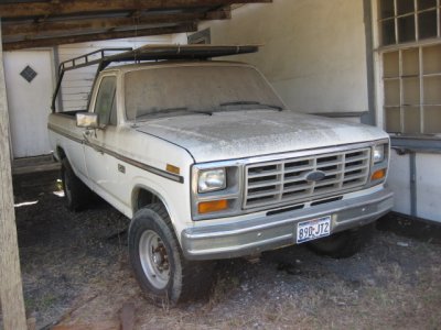

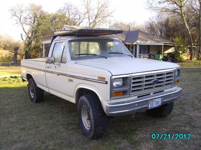

So long as the fuel doesn't go bad these trucks can sit indefinitely without any problems, heck for any vehicle a week or 2 is nothing.
1,443
this truck was parked from 2005-2012. note the dust. put in two new batteries and she fired right up.
Fordsnguns borrowed the truck and is driving it daily. HASN'T CHANGED THE FUEL FILTER YET. if the fuel isn't contaminated, you have nothing to worry about.
