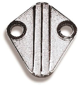

Tx towcat,
Reason I asked holley shows #2 as a chrysler cover but it looks like the same shape as our mech pumps on our trucks.
