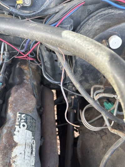

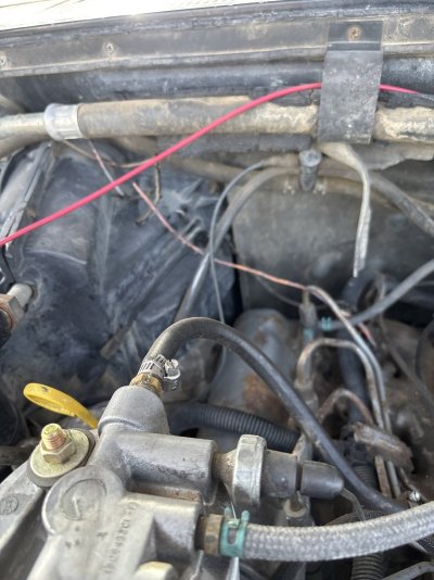

I hit a pothole today and my radio started glitching out then my cab filled with smoke and melted the ground wires on both sides of the block parking brake bracket is hot to the touch when battery is connected also lost brakes

Somewhere you have a hot short to ground. There's very few wires that aren't fused. Battery to battery, then battery to starter. I'm willing to bet it is battery to starter somewhere...
