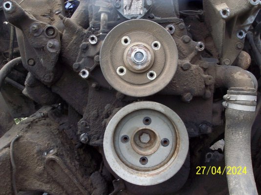

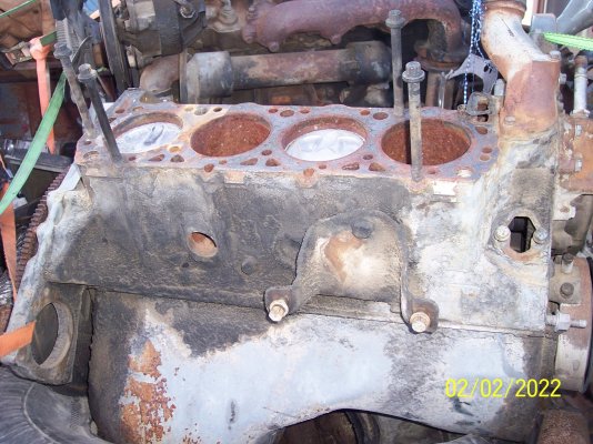

Neither of these are good pictures, but hopefully they'll help. In the front view, you can just see the two ground bolts after I put them back in place. The passenger's side one is a odd shaped bolt with a stud attached, like in the side view. It's located below the clean bolt holes on the water pump that the alternator adjusting bracket attaches to. The driver's side bolt is a regular bolt. It's located below the opposite side of the water pump. They are both right above the oil pan and they both take a 3/4" wrench or socket to tighten or loosen.
