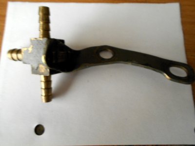

For those that never knew this line on the return from the top of the injection pump had an olive hidden in it.. Now you know. Also note that if the same olives are hard in the line from the lift pump to the filter inlet is hard.. so is this one as is both ends of the filter to injection pump inlet. See where the brass fitting with the three hoses are on it. that long piece has an olive in the end of it. If your engine has this steel hard line running down the drivers side of the intake manifold then you have this problem waiting to leak. http://www.ebay.com/itm/182162591942?_trksid=p2055119.m1438.l2649&ssPageName=STRK:MEBIDX:IT

And this is why I supply them with my return kits. Solves all common air problems
338
You could do away with that hard line to the rear if you have these. Just run a hose from IP into #2 return line cap. The tee is 1/4" x 1/4" x 5/16" to tank.
This is what I ended up using when I got rid of my smaller return line system. The system with the green clamps. The red clamps are the larger return line kits.. One more item not in Bill's pic is the filter air bleeder. I got that from Oregon Fuel Injection.

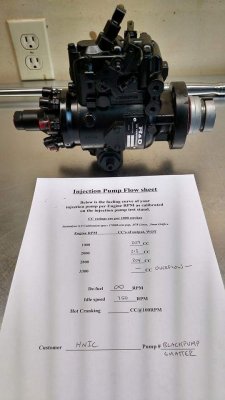

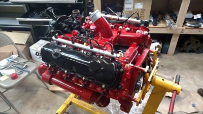

This may be the end all be all of return line kits...
attachment.php
Rails
Justin at R & D IDI Performance...

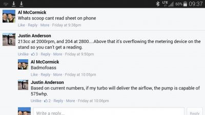

FYI...goal is 500+ hp in that scarlet monster...notice badazz black IP...
attachment.php
More fuel than any other IP I think...
attachment.php
Just sayin...return rails if prove to work would sure be nice to aleiviate the platic cap issue for sure and that dreaded rear Olive...
